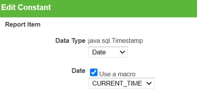

joe_morton
Mar 21, 2023 10:23 PM UTC
Instead of the database function, use a Constant, data type: date. Select macro CURRENT_TIME. I'm pretty sure that was out of the box on our system.
d_graham18-OpalAnswer
18-Opal
Mar 21, 2023 10:26 PM UTC
CURRENT_TIME macro is definitely OOTB.
That and CURRENT_USER macro have been around since forever.
avillanueva
23-Emerald II
Mar 22, 2023 12:51 PM UTC
Thanks, this is a work around but I will pursue a call to PTC since there is definitely something off. Constant macro shows correct.
