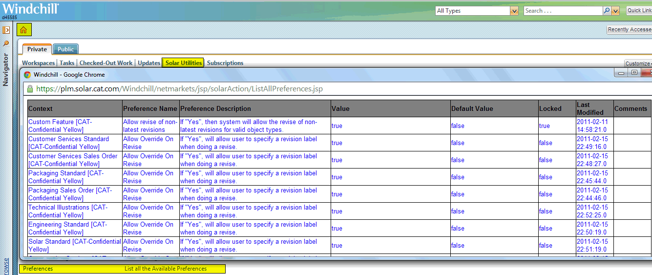

We have a JSP to print all preferences with their names, default values,
current values, and descriptions. It can be easily copy/pasted to excel.
We find that just having them in a format like this with their
descriptions makes it easier to see what is going on, especially as we
have many settings that are context-specific.

December 9, 2013
The report I provided actually changes color of the text for anything that
Solar changed from the PTC default. Blue is changed from defaul. Black
is default.
Like this...
Al
