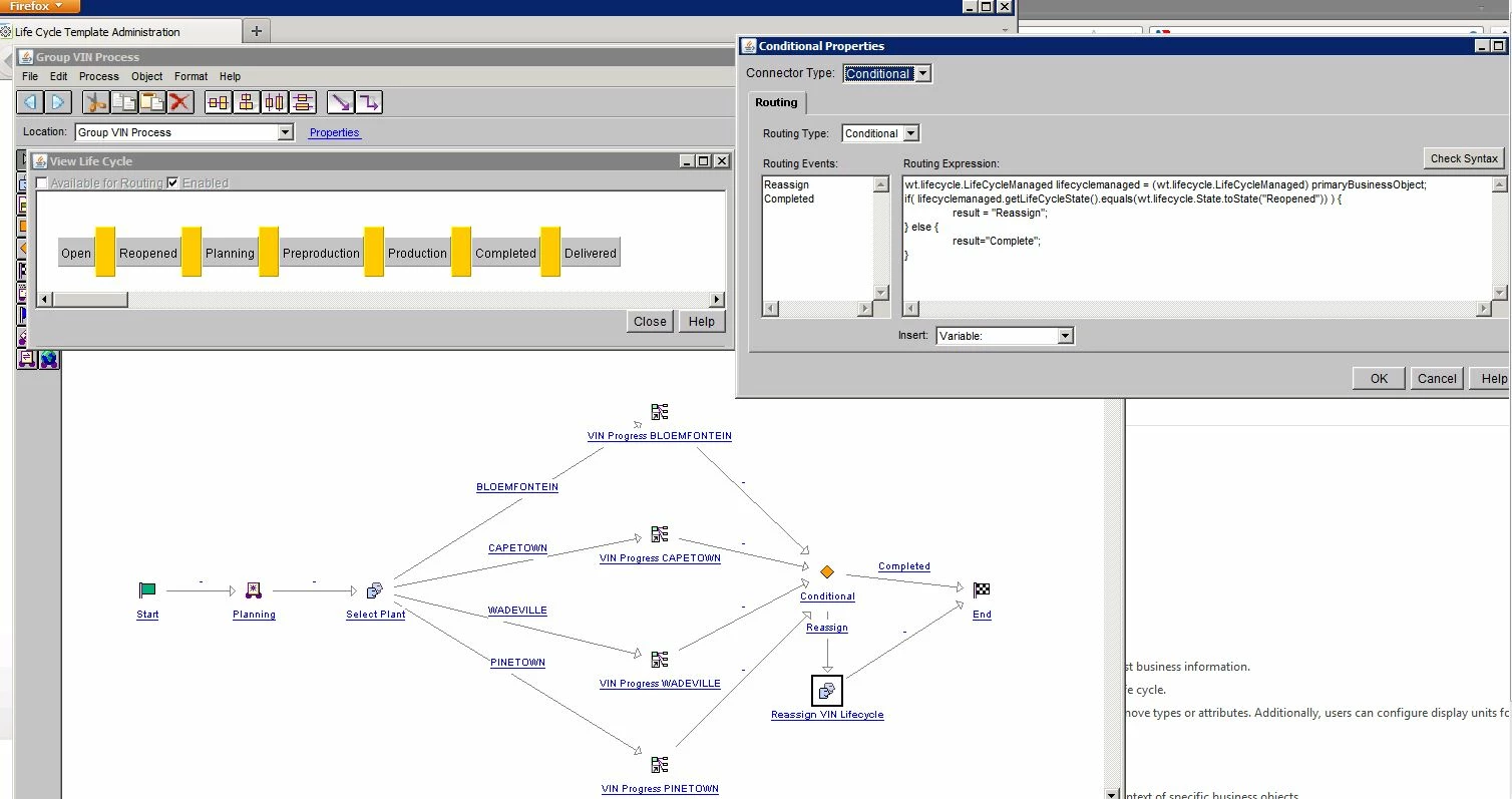

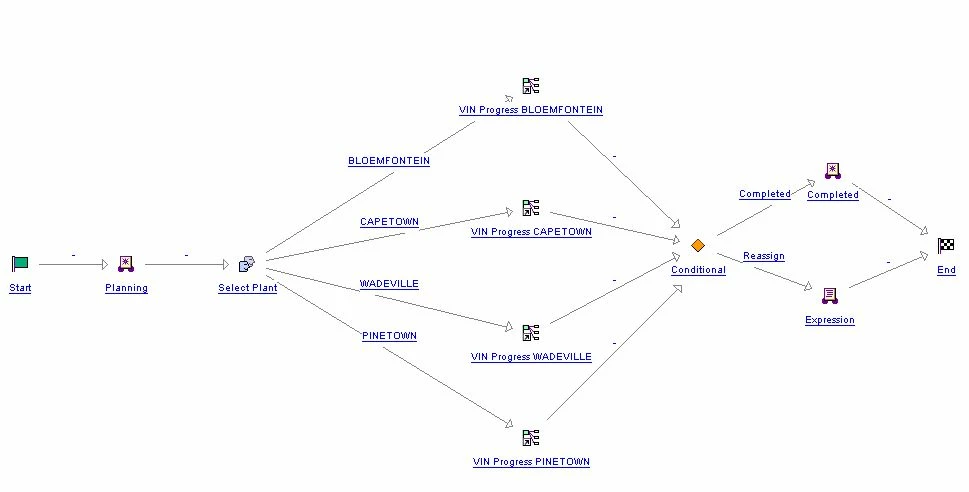

I have a workflow that requires that the life cycle of an object be reassigned in some instances. Currently I have a task that gets sent to the relevant user notifying them that they must reassing the life cycle of the object. Is there a way that I could use a robot in the flow that when a particular routing is fired then the pbo's lifecycle is reassigned?

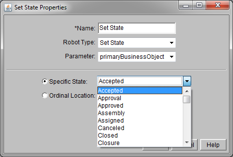

From screen shot it seems like you want to restart same workflow process i.e. set the state of POB to open so workflow will be trigger, in that case you can use set state robot to change state to Open (See screen shot)

Also make sure that end flag will have only one input otherwise workflow process will keep running ( See screenshot ).

@Igor, thanks but, i don't want to set the state, I want to reassign the LC. meaning all nodes are reset. Currently this can be done via the actions menu on a WTObject that is associated to a LC.
@ Mani, please explain the expression a bit for me. I entered it into an expression robot and I get the following 2 errors. I gather I need to create variable in my WF. What I have is subprocesses running based on the manufacturing plant selected. When the subs are done they leave the pbo in one of two states. Namely; Reopened or Completed. Now, I could't add a task to request a user to perform the reassign action, but I would rather have the system control that for obvious reasins of efficiency. Hence I want to reassign the LC and restart the wf automatically.

you can use Method Robot and set Robot Type as "Set State" - then select Specific State
