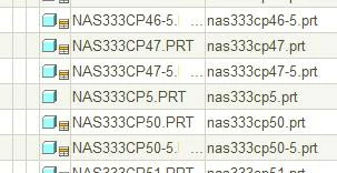

I am close to finishing a procedure for removing large numbers of
instances from family tables and purging out of PDMLink. This follows
loosely TPI 141775
<">https://www.ptc.com/appserver/cs/view/solution.jsp?n=141775> . The
problem is that the TPI does not scale. What if I had to delete 100
instances, or a 1000? The TPI has the user open all the instances to be
deleted into session while the deletion occurs in the table. Pro/E
would probably crash if I did 1000.
I figured out that all that is necessary is to save a model to the
workspace with the same filename as the instances that were removed from
the family table. For this I could use excel to get the filenames that I
am removing and feed that into a script that makes copies of the start
part (any model will do). Then I use the Import to workspace feature to
load all those models into the workspace. Now the upload will fail but
it is overridable. The resulting check in below shows the instances are
standalone now. Returning to the TPI, now I have to purge the history
and delete the standalone models.
Why does this matter? In testing we found two facts:
* The percentage of models we use from our family table (milspec
parts) is rather low. <12% in most cases. Some families can be 800-1700
instances.
* Regardless of how many models and/or instances are downloaded to
a workspace, workspace operations are affected by the total number of
family table instances that exists in the system. So if you had 1
instance out of 1000 added to your workspace, a sync operation still
processes (on the server) the 999 other instances. You pay either way.
