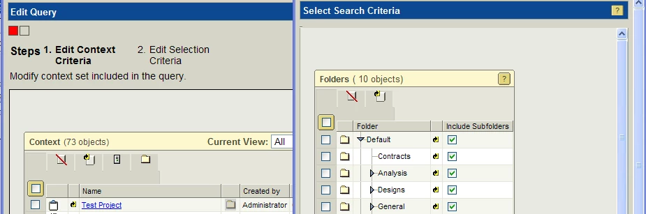

Thanks for the tip.,Steve.
But for all I can see it's not possible to make a query to look for all
iterations of only test.drw.
I can only select the following:

Yeah easiest way to do this will be to create a specific folder in PDMLink called "Purge Stuff". Then copy/paste your objects in question into that folder. Once that is done, create a general query that only includes that folder. Then run the purge on that folder.
