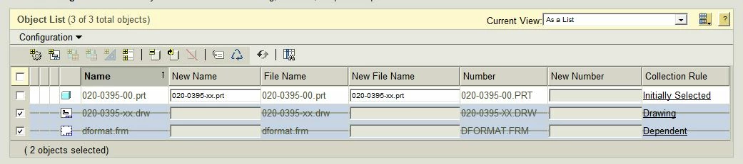

I keep getting this error on a few files i would like to rename.
Cannot change identity of object "EPM Document Master.020-0395-00.prt" to "020-0395-00.PRT" because new identity is not unique.
on the rename screen I am putting in a new name of 020-0395-xx.prt so I dont understand why I am gettig this error.

yes I can put anything in for the new name and i get this error. the number field is set to match the Name field.
