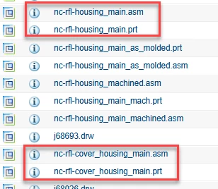

dsalotto10-MarbleAuthor
Dec 9, 2024 3:17 PM UTC
All I can say is this was normal procedure since the early 90's keeping the part and assembly the same name for things like harnessing and inseparable assemblies such as a sheet metal part with pem inserts or plastic parts with untrasonic inserts.
Here's a few of thousands of Windchill examples where we have the same name.
