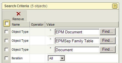

October 27, 2011
Alex and Mayur
Content Holder is the common interface for docs and epmdocs. So it is
able to replicate both.
However I removed that rule and add two new rules one fro WTDocument and one
for EPMDocument. Still it didn't replicate all the files.
What object type are you using for replication?
Prathap <">http://goo.gl/LuT5>

October 27, 2011
Prathap,
Here is how replication was setup when we did it.
[cid:image002.png@01CC94A0.15BDA4D0]
