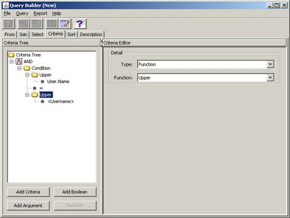

I found your report very useful since I had a very similar need. One more question: is there a way to make the query not to consider the upper/lower casechars in theparameter?
For example : I would like to get the same result if I give as parameter the username spelt as DAVIDE or Davide or DaViDe
Thanks for your help
Davide
July 15, 2010
Hi Davide,
You can change your criteria to use the upper function on the attribute and the parameter.
[cid:image002.jpg@01CB2400.FC694B30]
July 15, 2010
Dax,
it works! Thank you very much.
