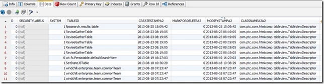

Anyone have a method to reset a table view to ootb settings?
Or import export?
Specially the ALL in the affected objects?
I attempted to remove the disposition columns, and the comments column goes too, and is not selectable to add back in.
-Vaughn

The customization guide shows some rather dangerous SQL to do this however if you know the table id this is better
DELETE FROM TableViewDescriptor WHERE TABLEID='xxxxx';
DELETE FROM ActiveViewLink WHERE TABLEID='xxxxx';
commit;
One easy way to find it is to create a new view in the UI, then check these tables and sort by the last updated column.
Here is my DB using DB Visualizer
BR
Simon

Deleting Table View from DB (2 sql's u mentioned)does not harm ur system. Ill be restored after Windchill Restart.

True, but any custom table views will be lost.

some of the changes (column order or hiding) are stored in the browsers local storage ...
try in javascript console:
for(var x in localStorage)
if(! confirm(x+"="+localStorage[x]))
break;
