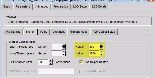

I am sure we've all seen this from time to time:
Jul 10, 2013 11:33:59 AM:Timeout exceeded waiting for a reply from the CadAgent - Time out 60 seconds
Jul 10, 2013 11:34:59 AM:Timeout exceeded waiting for a reply from the CadAgent - Time out 60 seconds
Jul 10, 2013 11:35:59 AM:Timeout exceeded waiting for a reply from the CadAgent - Time out 60 seconds
Jul 10, 2013 11:36:59 AM:Timeout exceeded waiting for a reply from the CadAgent - Time out 60 seconds
Jul 10, 2013 11:37:59 AM:Timeout exceeded waiting for a reply from the CadAgent - Time out 60 seconds
Jul 10, 2013 11:38:59 AM:Timeout exceeded waiting for a reply from the CadAgent - Time out 60 seconds
Jul 10, 2013 11:39:59 AM:Timeout exceeded waiting for a reply from the CadAgent - Time out 60 seconds
Jul 10, 2013 11:40:59 AM:Timeout exceeded waiting for a reply from the CadAgent - Time out 60 seconds
Tech support notes to adjust time out in wvs.properties
publish.cadtimeout.assembly=7200
publish.cadtimeout.component=600
publish.cadtimeout.drawing=7200
Been there, done that. So, with all your publisher queues displaying this scrolling message, is there any hope to fix? I tried deleting the executing jobs and just go to the next one. Those too, end up in this loop. I am looking for something to do without having to restart the system.

There are also timeout settings in the recipe file as well. I think that could be part of the issue. Try to increase these beyond 60 seconds.

avillanueva
23-Emerald II
Jul 10, 2013 5:21 PM UTC
Both of those are the values I have.

Thanks to those who are responding. This has been a great thread. My biggest frustration is that its not anything simple. The system (I believe) is configured fine. Timeout values are ok. Its not related to a bad assembly. We ended up bouncing the system and it all came back to life. The jobs that were hanging not processed with no issues, complete. During the issue, we also got calls that workflow tasks had stopped moving and there was a high number of active contexts on the background methodserver. It did not show high CPU or GC %. My technical term for this was its "out to lunch" and it was in fact lunch time.
It explained why the CadAgent was timing out. What I need a deeper understanding is where is the CadAgent running. I think some people on the threads were confusing the publisher, queues, agents, workers and helpers. I do not believe this was an issue on the Cad Worker machine (Daemon, helpers or workers). They were not getting any jobs to them. I could start and stop them with no issues.
My point of the thread was to see if there was a way, short of reboot, to return the background MS to normal operation. To unstick what was stuck. If there was some thread or process within the system, it would sure be nice to reach in an diagnose it without bringing the whole system down. That, in the end, is what we were forced to do.

We've had times where I've caused issues with the publishing queue and we found that we could kill the background m.s. process and servermanager will fire up a new one and operations will return to normal. This allows us not to have to bring down the whole application. This is probably not a best practice but it has worked for us when restarting the application would not be ideal.
