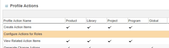

Currently, a context manager (Product, Library or Project) can use Configure Actions for Roles to allow other roles to Modify the Team.
The problem is that whatever role is allowed to modify the team can then add themselves to the context manager role.
On a lesser concern, they could also add users to Roles that they are not qualified to complete tasks assigned to that Role in a workflow.
Does anyone know if it is possible to restrict users from being added to a given role (Product manager, Library Manager)?

If I understand your situation correctly, your non-context manager users  end up in adding more team members and also accidentally adding themselves as context managers. Is that right?
Can you show a screen shot of the behaviour? To help us understand if we are talking the same thing?
I think the action can be hidden in UI by profiles.
Take a look at the help article.
https://support.ptc.com/help/windchill/r12.1.2.0/en/index.html#page/Windchill_Help_Center/team/TeamActionVisibilityConfigure.html#
Let us know...

Hi @LG_10096154
I would recommend to use the profile to hide the Configure Action to a managers.
btw it is responsibility of the Manger if he allows some users to modify team and then the responsibility is moved to the person who got the option to modify the team.

You can create a custom role which can modify members of any role in the same team except manager roles.
Create a new custom role with enumcustomize, we called it PLM Team Manager. Add PLM Team Manager to existing context teams and configure the action, modify team. The PLM Team Manager can’t add themselves or anyone else to the Product Manager role.
