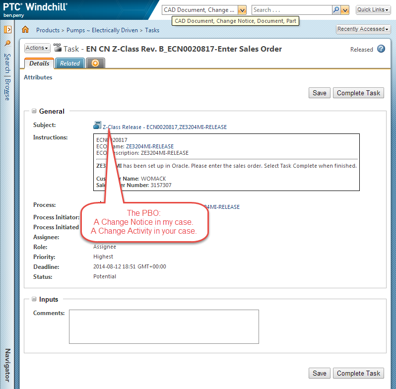

Kristie,
In my opinion, PTC has taken a step back here. But other people like this because the workflow tasks are less cluttered. I wish there was an option or preference, but there is not.

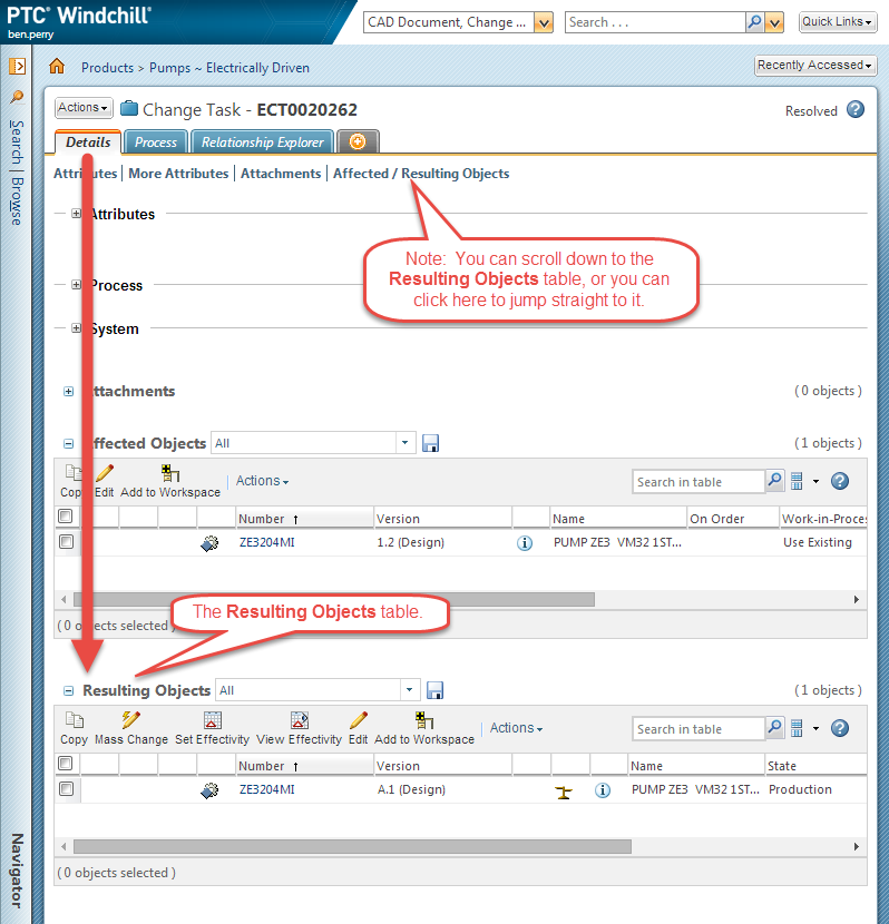

In essence, what you were seeing was the information page for the PBO (Change Activity in your case) shown below the workflow task in 9.1. This is no longer an option. You must click on the hyperlink to the PBO to open the information page for it, and then navigate to the Resulting Objects table.
So in summary, a "scrolling action" is now a "click and scroll" or "2-click action" to look for what you were looking for in the past. But as I've said, this helps reduce clutter on the workflow task page.
