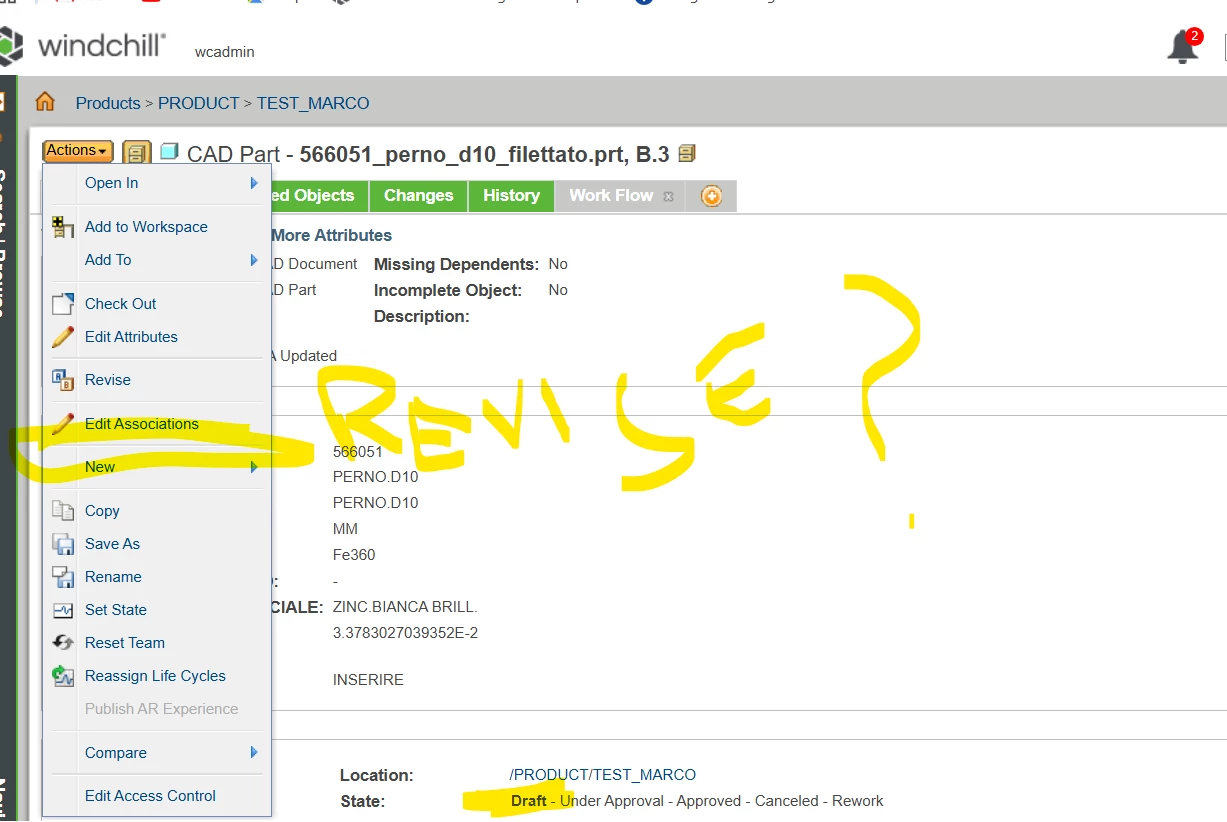

Revise active according with lifecycle status
In the OIR i set for a user Revise NOT possibile in only Released stase in epmdocument. For other states, for example draft, revise should be possible. But is already obscured

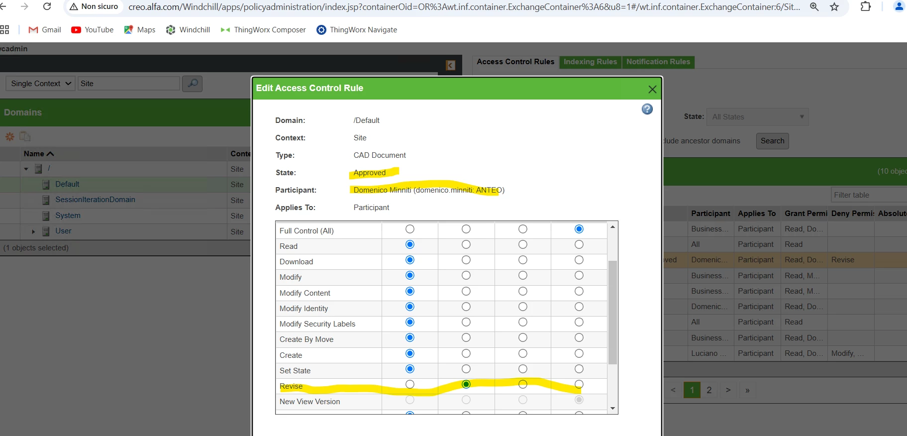

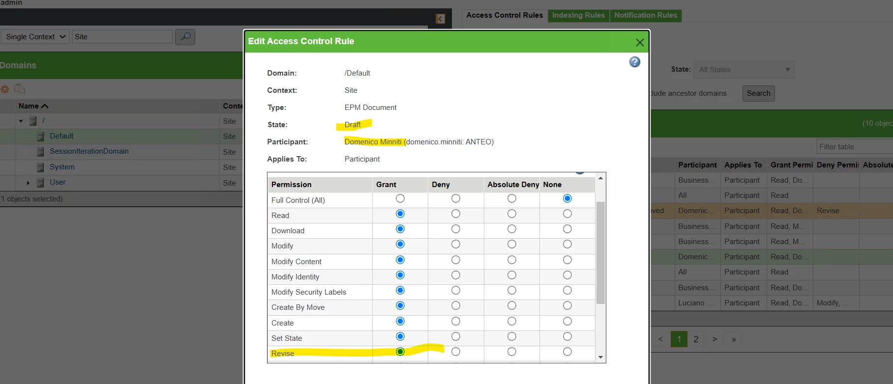

I see the root  case.
Your ACL rules define the Deny rules directly on the user. So others rules are rewritten.
The MINUS means Deny. So your ACL definition contains a users level ACL definition that rewrites all upper rules from domains.
Change it and the user will get the Revise rights.

Configuration of ACLs rules on Approved status and Draft status
In draft status Revise icon is missing

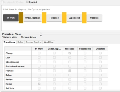

- I guess that you have to have correct LifeCycle Template configuration, where the revise transaction is allowed,
- then ACL create has to be granted to the user in the target state where the new revision will be placed
- check the profile configuration if you use profiles.

My business requirement is:
if the epm document is "Approved" Revise icon should be hidden
if the epm document is in "Draft" Revise icon should be visible.
Now is set in this way by acl rules, but in "draft" status Revise icon is hidden however

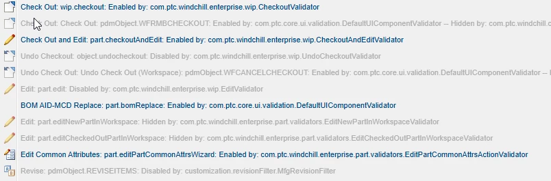

Tests you can do: Add "&jcaDebug=true" to the end of the URL on the EPMDocument page you are viewing in Draft. You will see a bunch of lady bugs appear. Click the actions drop down and see why the action is being disabled. It should say the validator or filter that disabled it.

Lastly, we should check the lifecycle template for your EPMDocument. Do you have Revise checked? This is showing its allowed in my In Work state but my ACLs only allows admin to do that.
