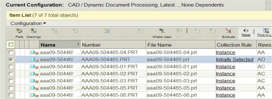

A user was revising a generic at AB to add some instances and ended up with an AD revision of the generic - he wanted an AC. I'm having trouble removing the AD rev. Any idea how to fix this?

David....ultimately you may not be able to but I'll share some thoughts to try. To Delete the generic AD you must collect all the new instances that were created and/or all modified instances with the ADcheck in. Delete all together at one time. Now, if there are 'where used' dependancies of any of the new instances you will not be successful until those references have been Deleted from Commonspace as well.
