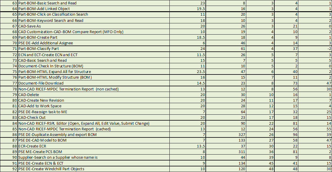

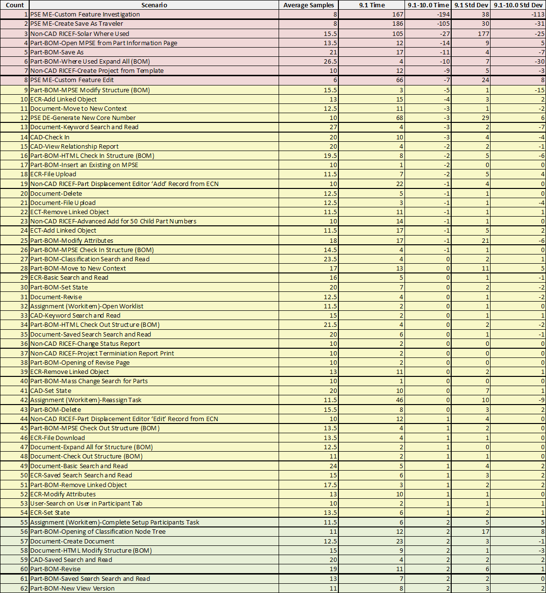

Below are our results with the slowest 10.0 tests relative to 9.1 on top,
and the fastest 10.0 tests relative to 9.1 on the bottom. Note that the 2
slowest processes were "sub processes" tested by business users. Those
two "bad" results had such high standard deviations that we could not
really tell if 10.0 was actually slower, or if the users were just
unfamiliar with the new picks and clicks. I suspect that most of that
slowness was due to unfamiliarity with the new system in just those 2
cases.

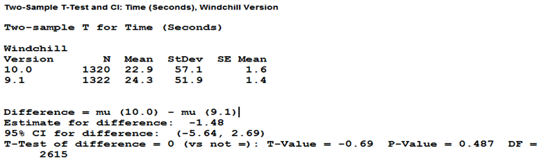

Below is the 2-sample T-test for 9.1 vs 10.0 indicating that while 10.0 is
"faster" than 9.1 on average in our test, that difference is not
statistically significant.
Since the P-Value is greater than 0.05, we fail to reject the null
hypothesis that the means are the same - essentially saying that 10.0 is
not significantly better or worse than 9.1 for our implementation.
Interestingly, when we first did this analysis, our 10.0 average was about
5 seconds slower than 9.1 with a P-Value of 0.000, meaning that we had to
reject the null hypothesis that the means were the same - essentially
saying that 10.0 was significantly slower than 9.1 until we fixed the
problems we could identify, and rerun our tests.

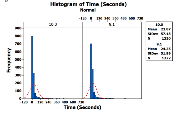

Here is a histogram of the 2642 tests that we performed as part of our
performance assessment for the 10.0 upgrade to "prove" 10.0 was as good or
better than 9.1 to our business stakeholders.

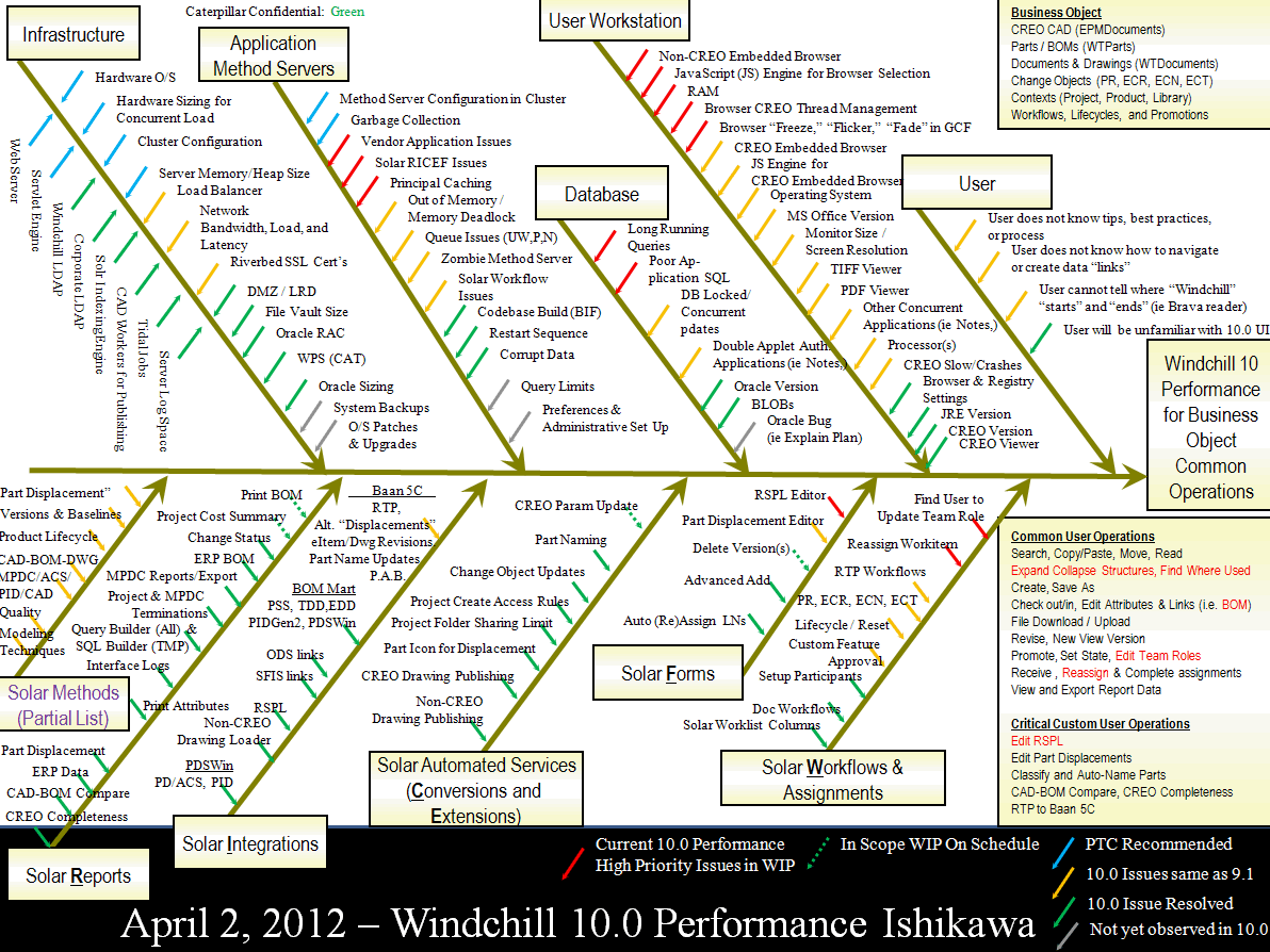

Early in the performance tuning process, we ended up making a Ishikawa of
all the various sources of "performance" problems to help us make overall
performance better, and communicate that "performance" isn't one thing so
much as a lot of things that can overlap and interact. The bottom section
is all Solar-specific stuff (mostly customizations), but the top section
is probably useful to all companies. The colors of the lines
(green/yellow/red) indicate status on various performance problems or
potential sources of problems as of 3 month prior to our go live. By go
live, each of the arrows was green. This helped communicate and
categorize our performance work efforts. The alphabet soup of acronyms
under "Solar Integrations" are various other IT systems that we have
Windchill connected to.
