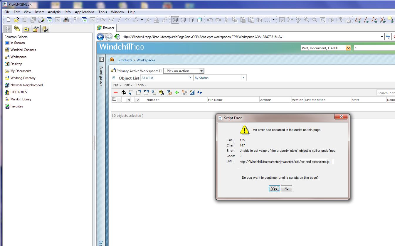

Is anybody else getting a million script errors in Windchill 10.0 when running it inside of Pro/E? Something like the following?
These pop up periodically. Not so often that they prevent us from doing work, but often enough to get annoying. We just implemented Windchill at the beginning of this week. Has anyone else seen this? Thanks...
Best answer by Bob1
Yes, we did find the answer. We upgraded to M030 and that did the trick.
Actually, a few months after that, the script errors started popping up again right when we launched Pro/E. And digging around, we determined that it was now because we had ptc.com as the default home page for the embedded browser within WF5, and PTC made some change to their webpage. So we changed the WF homepage to our company's intranet page, and that solved the problem again.
So I think the only way for you to get rid of your script errors is to change to M030...

i have exactly the same problem with my embedded browser and it really is annoying. it's better you use Mozilla firefox as embedded browser. however i think this is not the solution for this problem. using firefox is causing other (less annoying) problems. There has to be another way to fix the problem...
February 8, 2012
I have no idea what's behind these issues.
That said, which 10.0 is this? If it's not the latest available MOR (currently M030), then you're just asking to suffer from known issues that have already been fixed.
Bob11-VisitorAuthor
February 8, 2012
For the record, I'm using M020. Does M030 fix this problem?

Did you ever find a fix for this issue? I still have these popping up all the time. We are on Windchill 10.0 M020 and using CEPRO5.
Buddy
Bob11-VisitorAuthorAnswer
December 27, 2012

Yeah I just got through upgrading to WC 10.1 M030. I have not seen any since the upgrade so I guess problem solved. Thanks for the feedback.
Buddy
