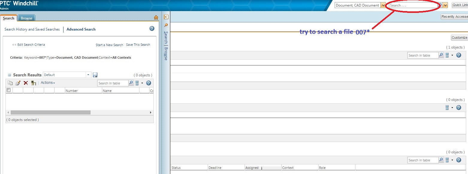

Hello!,

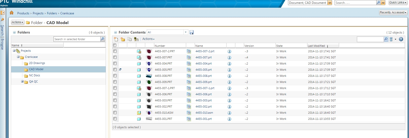

I'm confused of using search in windchill. I have cad files on my folder. but when I'm try to search it. it give me no results. How come that it give me no results?.
This is my cad files. I want to search 4455-007.prt
Assuming that i dont know the exact file name so that I type 007* in the search tect box.
Can somebody help me about this matter? thanks!
Luar
Best answer by mrane
Hi Luar,
I see the problem with the search criteria in the keyword field.
Try giving the search criteria as *007* instead of 007*.
-Malavika

Luar1-VisitorAuthor
November 13, 2014
Thank you!
