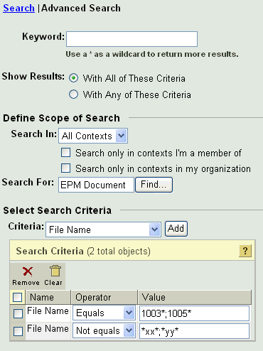

Is there a way to change the behaviour for multiple Search Criteria in Windchill?
Currently multiple criteria are treated with an OR statement (even though With All of These Criteria is set)
But I would like to use multiple criteria with an AND statment.
e.g. Search forFile Name equals 1003* or 1005*
ANDFile Name does not equal *xx* or *yy*
The search below in WC gives an error (search result size has exceeded the limit) because it treats both criteria with an OR statement and thus yield too many results with the second criteria:
(... we are on Windchill Intralink 9.1 M050)
Kind regards,
Olaf Corten

Olaf,
Add the following property to the wt.properties file:
com.ptc.windchill.search.client.overrideAndOrOperator=true

Great discussion, just to clarify, docs say this:
The Search Criteria table allows you to build detailed search queries by
selecting specific searchable attributes and specifying the attribute
values on which to search.
Note: Multiple values can be specified for attributes by adding the
attribute to the table more than once. If you specify multiple values
for a single attribute, there is an implicit OR relationship between the
two values. For example, if you specify the Name attribute twice, with
values of part* and gear*, your search returns results which match
either of those values.
So, this wt.property setting switches it to an implicit AND
relationship?
Olaf, where did you pick up the convention of delimiting multiple search
criteria with a semicolon? I could not find that documented. This allows
you to do ANDs and Ors now. Great work.
October 14, 2010
Antonio,
Yes, that is correct. The property below changes the advanced search behavior such that it treats multiple criteria for the same attribute with an AND relationship instead of the default OR relationship. This has been tested and implemented successfully in PDMLink 9.1 M040.
