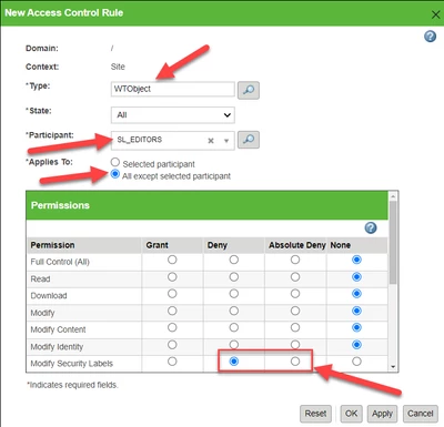

We have security labels setup just for the download ack message, so we have not enabled agreements (not needed - We control access by other means).  I know specific PTC license is required Base + IP Protection, or the advance (which includes IP Protection), but the PTC steps (Edit) implies restricting who can edit them without explanation.
I am looking to set them so only SL_EDITORS can modified the Security Labels after creation.  Any help would be welcomed.   Thank you in advance.

You would need to create an ACL something like this with a deny or absolute deny:
May 16, 2024 6:25 PM UTC
I attempted two policies, one at the highest level to deny (did not stop) and one at a context level to allow (again no difference), but it did not seem to make a difference.  I did have success using a  new Profile that I could attach to specific groups into.
What I was wondering if there was a change to configuration files while updating / installing the SLs that could be set.
Between the profile and not issuing a IP Protection license I could in theory, but it becomes more to manage.
