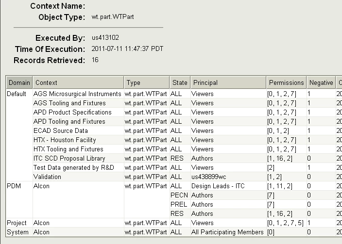

Hello
is there a way in PDMLink to pull out the overall access permissions of each users, user groups etc. ?
I cannot find any tool from the site utilities page.
Is it something companies have to develop themself or buy a third party software ?
Thank you

Attached query builder report should be helpful.
Typical output:
[cid:image001.png@01CC3FC0.6DDDE0B0]

I have tried and it works pretty while.
Where can I get the meaning of the permissions, 01,2,3 etc.. ?
Also do you think this can be developped to get the level of permissions for each individual users. We have users in several usergroups as you can imagine.

Hello NacNac,
You can find the definitions of these inAccessPermissionRB.rbInfo file. You will find it in <wt_home>/src/wt/access.

-1.value=Full Control (All)
0.value=Read
1.value=Modify
2.value=Create
5.value=Delete
6.value=Administrative
7.value=Revise
8.value=New View Version
9.value=Change Permissions
10.value=Download
11.value=Modify Content
12.value=Change Domain
13.value=Create By Move
14.value=Change Context
15.value=Set State
16.value=Modify Identity
Apr 10, 2015 7:47 AM UTC
One route to obtain an ACL Report is to run WINDU, with I think Domain Policy option only.
another is command line:
windchill wt.tools.support.ACLReport <output_file>
per ptc page: https://support.ptc.com/appserver/cs/view/solution.jsp?n=CS116472
I havent tried the 2nd route & if it works well, it would like be easier than the WINDU method.
