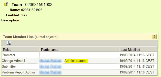

But group of all Administrators are assigned to the Change Admin I role after running new preccess instnance.
How can I get rid of them? I want only the specific user to be assigned.

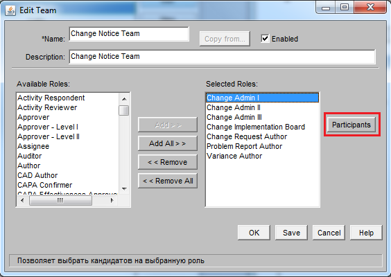

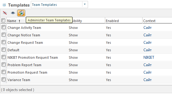

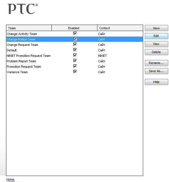

You should edit team template.
1. Open team template administrator
2. Select your team template and edit it
3. Choose your role in the Selected Roles field and press participants
4. RemoveAdministrator from this role

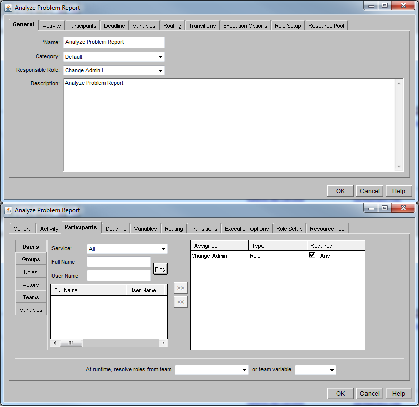

Site > Utilities > Workflow Administrator > Problem Report Workflow
Analyze Problem Report Assigned Activity
There is Change Admin I set as responsible role under General tab.
There is Change Admin I role used under Participants tab.

But when I run testing Problem Report there are Administrators group and Change Admin I role (or group) assigned to the Change Admin I role. I don't want Administrators in that role.

Check activity in the workflow. May be two roles assigned with this activity.
Stanley1-VisitorAuthor
September 22, 2014
There is only Change Admin I
