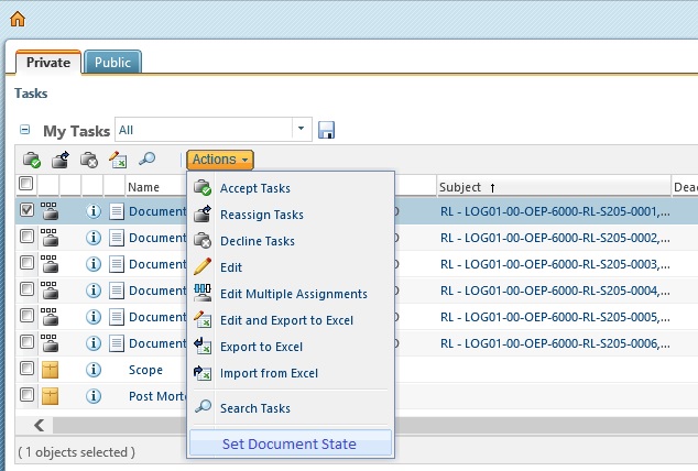

Hi all.
I have an assignment in my home that is started from an workflow.
This assignment is associated to a document.
I need to set state of the document within the assignment using an action from the home assignments interface.
Anyone did this before or know how to do?
