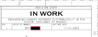

I would reverse it. There should be attributes pushed down to the Solidworks file from Windchill that give you the Windchill revision of the object. When you revise in Windchill, it would update in the Solidworks file.  Sounds like you are keeping a table of revision history (running list of revisions, dates, changes, etc). Typically, the current revision appears somewhere else like lower right of drawing. That should be drive by Windchill which would automate things for you. As far as the running table, I cannot see a way to link that unless you create some kind of macro. As an aside, we ditched the running revision table in place of a simple block pointing to last change notice. Full history would be found in Windchill and avoids having to manually renter this data again on field of drawing.

Sample:
Lifecycle also is linked and republished on state change.

I would but its from 2015. Chances of getting that from PTC are nil. As for ASME Y14.35, is required the right word or "suggested". In the days of paper drawing, a lot of information was crammed on to the drawing. A good example is Where used, qty. etc. That stuff can change at anytime outside the drawing release and is best managed in the PLM system. We've been slowly removing this data from the drawing which simplifies creation and yields more accurate data.
