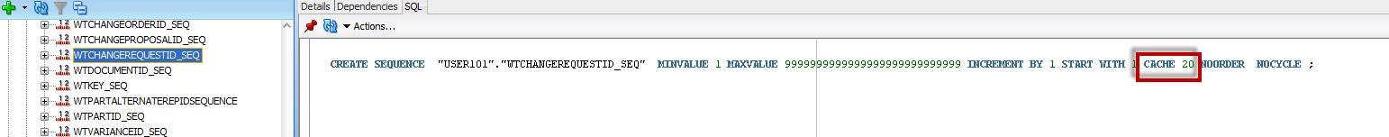

All Windchill sequences are created from the Windchill Solution Installer.
Hard to understand why PTC does not fix this fundamental issue. At a minimum it should be documented in 64 FONT, Red, how to do so.
Each has SQL somewhat like this.
[cid:image001.png@01CF8EF1.CAA1FD30]

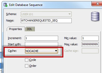

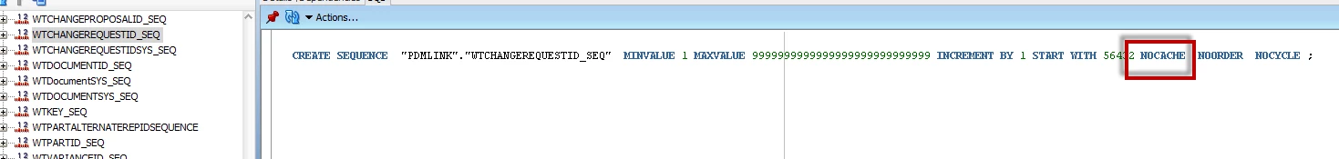

You have to one by one change each sequence to NO_CACHE.

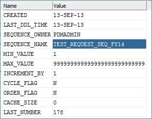

Group,
I seemed to have no issue with this command (with syntax as shown in Mike's screenshot) to create my custom sequence:
create sequence TEST_REQUEST_SEQ_FY14 increment by 1 nocache;
The key was adding the operator nocache. Of course this goes against PTC's suggestion of how to create a custom sequence:
exec wtpk.createSequence('TEST_REQUEST_SEQ_FY14',1,1)
