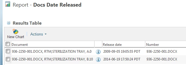

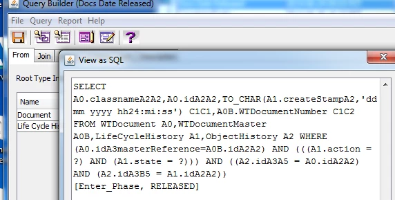

No need to use SQL to the database.
Attached is a query builder report that does this except for the Organization. Returns all Revisions. Here is the SQL that the Report builder creates and uses.
[cid:image002.png@01CF8F8C.25520780]
Accepts Number input - can set up to accept any other input.
Note: Number included as a 2nd column in order to provide it as a user-enterable parameter - redundant output. The first column is a hyperlink to the Document.
* From Document
o Select: Number
o Select: Name
o Select: Version
o Criteria: Latest Iteration (shows Release of all Revisions if done this way)
* From Lifecycle History joined to Document on Object History, set criteria
o Constant: State = Released
o Constant: Action = Enter_Phase
o Parameter: Created (got to this state) date range

Eric,
Below SQL will return all Documents released in Last 20 Days.
) AND (A0.action = 'Enter_Phase'))) AND ((A3.idA3A5 = A1.idA2A2) AND (A3.idA3B5 = A0.idA2A2)AND (A1.idA3containerReference = A2.idA2A2)) and A1.idA3masterReference=A11.idA2A2
