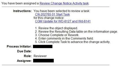

Just wondering if anyone else has ever seen this kind of behavior from Windchill change task emails (or any other Windchill emails for that matter).
We have modified our emails to include the name of the Change Task as a hyperlink and the name of the Change Notice as a hyperlink. The change workflows extract this data and embed it automatically into our emails.

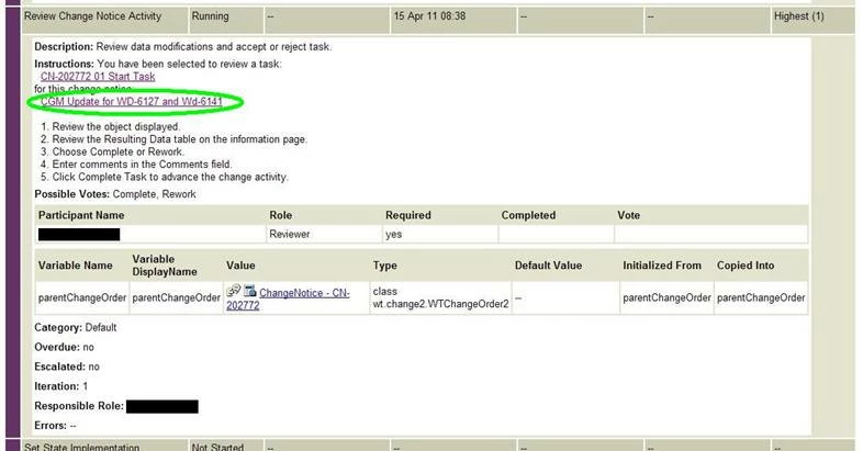

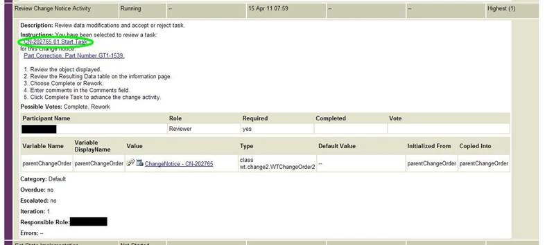

A couple of weeks ago one of our users received one of these Change Task emails. He just now noticed that the email did not have the correct name of the Change Task. Instead it included the name of an unrelated Change Task! Stranger still was the fact that the hyperlink took him to the correct Change Task! And on top of that, the Process Manager shows the correct contents for the email.
The link ID numbers are not even close. The Change Notices are not close. The task assignees are not the same. The Change Tasks were assigned on the same day but 30 minutes apart. I don't see any way to track down what happened in this particular case and don't think I'll ever be able to replicate it. I just wondered if such an odd behavior had happened to anyone else.
