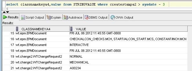

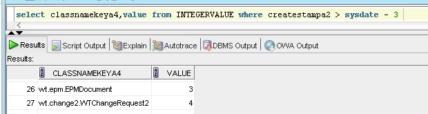

22-Sapphire I
July 9, 2012
STRINGVALUE for most
INTEGERVALUE for Integers
Notes
These are common for attributes assigned to all types (e.g. attributes on Change Requests, WTParts, etc.).
Tables can get very large especially STRINGVALUE- dedicated tablespace and multiple datafiles helps performance greatly.
Can use these directly in query builder and other reports.
From our production database:
[cid:image001.png@01CD5DA2.65F48060] [cid:image002.png@01CD5DA2.65F48060]
[cid:image004.png@01CD5DA3.1364FBD0]
[cid:image003.png@01CD5DA2.BEA2AE30]
