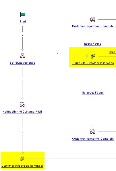

Is there an easy way to stop a user from completing task until an earlier parallel task is completed?  See attached picture, I want to block the Complete Customer Inspection from being completed until the Customer Inspection Reminder is completed.

Put them in sequence.

Yes Don...the simplest answer is most of the time the best way to go, but I want the Complete Customer Inspection task to be visible on the users home page from the minute the PBO is created.

So, you want CCI to be a task on the assignee's homepage while CIR is ongoing. Can CCI do work on the task while CIR is ongoing?

Maybe the obvious question here, but is there a particular reason both tasks have to be sent out in parallel?  Why not just have Complete Customer Inspection not be sent until Customer Inspection Reminder is completed?
Other thing you can do (though not exactly what you asked for) is to have both of those tasks go to an "And" connector node before anything else in the workflow.  While the two tasks can still be completed in either order, the workflow will wait for BOTH to be completed before going further, which is not what is happening in your image here.

Bob, but the user can still complete task accidentally and the task disappears.  If they have to wait until the prior task is completed, the work will then get done as the Customer will actually be on site.  The next question I am sure you'll ask is what is stopping the first task from being completed..., I have code that checks against an attribute date and will not allow completion until a couple days before that date.
Oct 13, 2015 1:11 PM UTC
One option you can have is to have "Complete Customer Inspection" on a loop link, where after completing it goes to check the value of a workflow variable (call it CIRComplete, initialized with value of 0).  If this value is 0, go back to the "Complete Customer Inspection" task and rerun.  If the value is "1", progress onward.  This way, if a user does this task first, the task will just reappear in their list.
After the "Customer Inspection Reminder" task is completed, send it to an expression to change the value of CIRComplete to 1.  NOW when the user completes "Complete Customer Inspection", it will progress.
