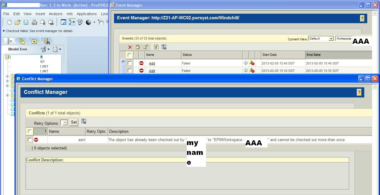

My workspace name is AAA.
I’m confused the BB.drw, indicate it has been checked out by you in another workspace. But I don’t know the where the workspace and I didn’t create the “EPMworkspace-AAA”.
Try to check out again, indicated “The object has already been checked out by "myname" to "EPMworkspace-AAA" and cannot be checked out more than once.
Where is the "EPMworkspace-AAA"?
What’s problem??

Hello Jin,
Did you try to see the workspace "wcadmin".
Regards
Pascal
February 18, 2013
Do you have a "checked out" tab or table under the Home tab? I think you'll find the "working" copy of your object there. This one will probably have a pencil on the icon. You need to check it in or undo checkout. You could also try doing a search for the object by name. You should get two results, the "original" and the "working" copy.
