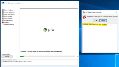

I am installing WC 11.2 on Windows server 2019 with oracle 19 c.
While running the PSI installed it failed error Tomcat installation failed. Can someone guide waht is the root cause. IT somehow running the Unix script for the windows.
error message for more detail
INFO 2024-04-29 17:50:27 - ###################################################
INFO 2024-04-29 17:50:27 - Running tomcat Installer
DEBUG 2024-04-29 17:50:27 - calling executeInstaller(C:\Windchill112_CD_Images\MED-60419-CD-112_11-2-0-0\Tomcat)
DEBUG 2024-04-29 17:50:27 - Processing subinstaller assembly (tomcat): timer.start
INFO 2024-04-29 17:50:27 - installDebug: Calling subinstaller tomcat command
INFO 2024-04-29 17:50:27 - Running: /usr/local/bin\cscript.exe //E:vbscript C:\Windchill112_CD_Images\MED-60419-CD-112_11-2-0-0\Tomcat\setup.vbs WAIT LAX_VM C:\Program Files\java\amazon-corretto-8.342.07.3-windows-x86-jdk\jdk1.8.0_342\jre\bin\java.exe -f C:\ptc\Windchill_11.2\PSI\installer\PSITempProps\tomcat-installer.properties -DMULTI_PROGRAM_EXEC=1
ERROR 2024-04-29 17:50:27 - java.io.IOException: Cannot run program "/usr/local/bin\cscript.exe": CreateProcess error=2, The system cannot find the file specified
DEBUG 2024-04-29 17:50:27 - Installation is Aborting. The installation cannot continue.
It would be great help if we get the solution how to proceed.

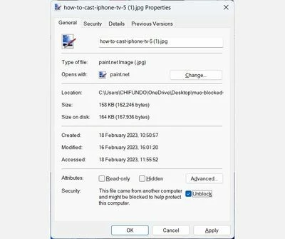

Is user account control turned on? If so, you might have to find the exe's in the distribution and unblock them.
Other things to look for - Antivirus? Firewall?
