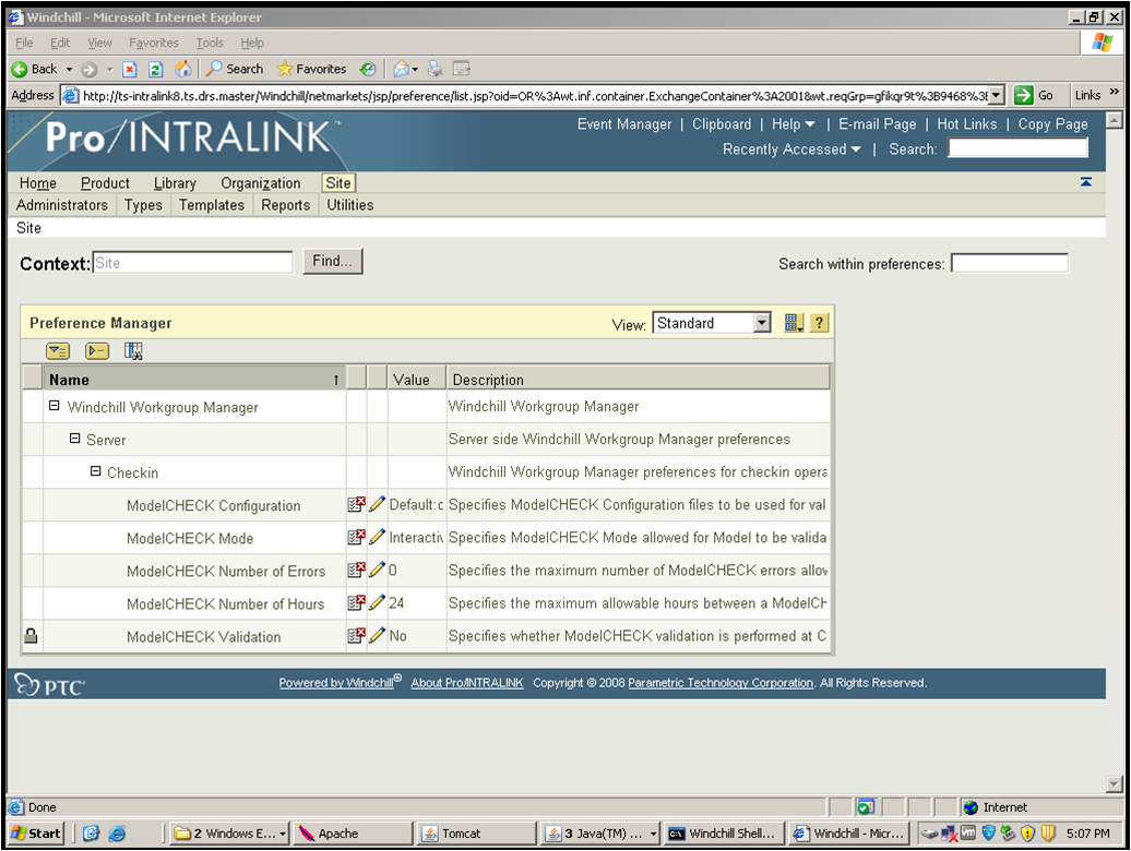

I would like to restrict check in of models/assys if there are any failed checks in my modelCHECK report.
Has anyone successfully done this? Can you give me some insight? Details? or point me to the correct documentation?

October 25, 2010
Thanks Tom,
I am just now getting back to this project.
I have found the following with the search for ModelCHECK as you suggested. However, I do not see anything about Gatekeeper?
Also, I don't know if you picked up on the nuance, but we are in Intralink 9,1 not PDMlink..... that may make a difference?model-check-intralink-ties.png
October 25, 2010
Hello David,
You don't see the text "Gatekeeper" appear here, but look at the last preference in your screenshot: "Modelcheck Validation". It is set to no. You can also notice that by default it is locked at site level. So if you want to set it in a different context (Product e.g.) then you should first unlock it at site level and then set it to yes in the specific context. This will enable modelcheck validation upon checkin. Also specify the correct Modelcheck configuration files to be used in the preference 'ModelCHECK Configuration'. Setting the Mode to "Save" could be a smart thing too.
Don't worry whether you are using PDMLink 9.1 or Intralink 9.1 - They're both "Windchill Technology" . With relation to Pro/ENGINEER Data Management, both PDMLink and Intralink work the same 😉
Don't hesitate to get back to this topic if you need further help - if time permits, I am willing to add some more info.
