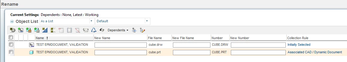

My predecessor at my current company we are not able to change the Number. We can change the Name and File Name with no problem.

How does your screen differ from this?
[cid:image001.png@01CF18E9.73FE83A0]
msexton1-VisitorAuthor
January 25, 2014
Mine number column is grayed out.
At one time auto numbering was turned on. We turned the auto number off but missed something in the
process to be able to re-number the existing components.

As someone else said earlier today, must be the OIR (I stand corrected). PTC has not been consistent in specifying how to disable autonumbering.
Need to get tech support involved.

It is in the object OIR in each context or organization:
You will see this for autonumber generation for WTPart OIR:
<arg>{GEN:wt.enterprise.SequenceGenerator:WTPARTID_seq:10:0}</arg>
</attrvalue>
Just add this in the bottom of the OIR:
<attrconstraint id="number" algorithm="com.ptc.core.rule.server.impl.GatherAttributeConstraints">
</attrconstraint>
Hope this helps.
