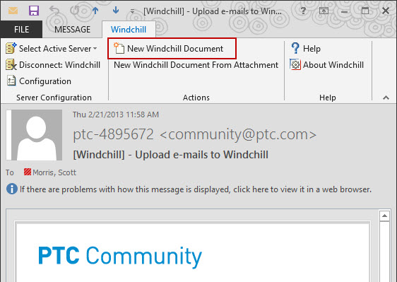

This does not answer your question about how to auto-populate all the attributes, but you can create new Windchill documents directly from Outlook using Windchill Desktop Integration. A .MSG file will uploaded with the new Windchill Document.

I already do this to create email documents. And I guess this functionality (DTI) is very helpfull. But it would be perfect if I could auto populate attributes.
