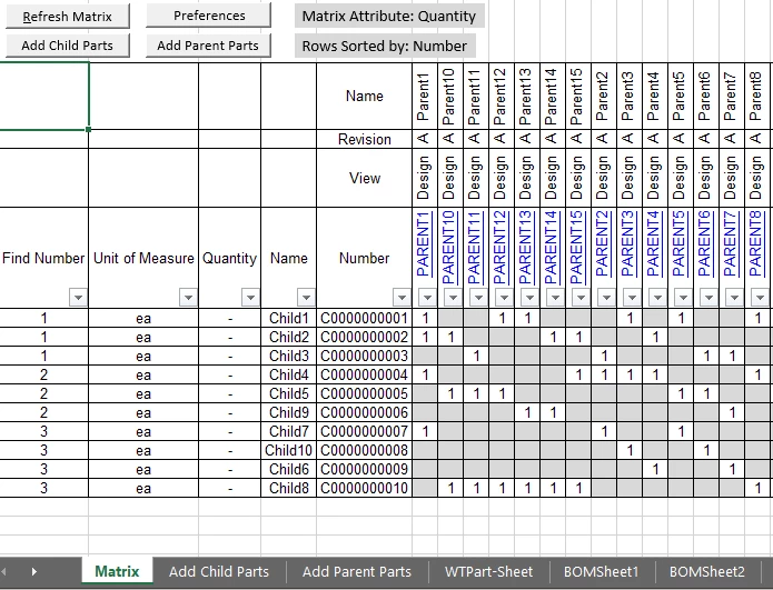

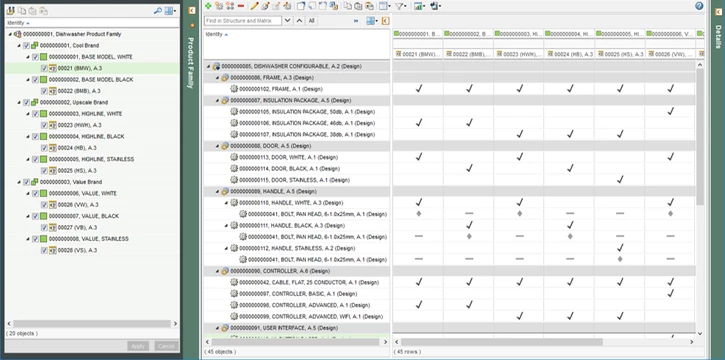

@magnus.salomons it would be good to understand the use case that you have for common BOMs and if they fit a pattern for modular design.  If so we would recommend looking at a platform strategy with a Configurable BOM and Options and Variants.  This would allow you to use the Product Family matrix editor to view, manage and plan the range of variant configurations.
For static BOMs that are similar there are two options
  1. With Platform Structures there is an Excel BOM matrix tool where you can view and edit a BOM (1 level)
  2. Last Fall Wincom released the Component Matrix as part of the Engineering Bundle.  It lets you view and export many BOMs with alignment by Part Number, Line Number, Find Number, etc.
Excel BOM view
Component Matrix example

In this case for creating and editing the BOM of the modules the Excel BOM matrix tool seems to be almost exactly what we're looking for. The almost comes from that maybe the pop-up window in Advanced Assembly Editor might be a bit smoother than starting Excel.

@JeffZemsky just some feedback after a demo with our VAR. They demoed the Excel BOM matrix in their test environment and I'm sorry to say that this was very disappointing. This looked more like an Admin tool than something a daily user would use changing a BOM structure in Windchill. Just seeing the screenshot you provided I assumed it would work more like editing a Family Table in Creo using Excel.
The Component Matrix looks much better. We will investigate if it's a help editing the BOM structure one by one with the Component Matrix view on the side. This tool would be perfect if it had editing capabilities. Then it would be the replacement of the Advanced Assembly Editor.
