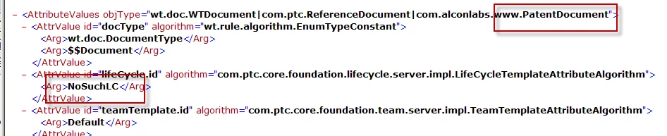

Keep in mind that you can also assign a different lifecycle, numbering, etc. to the same type in a different Product or Library. We do this in many special-purpose Libraries such that the root document type has a completely different process depending on where it has been created.
One workaround that we use (and we know that many others do as well) is to limit what type(s) can be created in any given Product or Library. There are no tools from PTC to do this, but this technique works perfectly. Simply specify in the OIR for each type that you do not want to allow a lifecycle that does not exist. The system pre-validates against valid lifecycle(s). If there is only one valid lifecycle, it skips past.
Example - we prevent Patent Documents (which is a sub type) from being created in the Library where this OIR exists:
[cid:image002.png@01CD3763.37C3EF10]

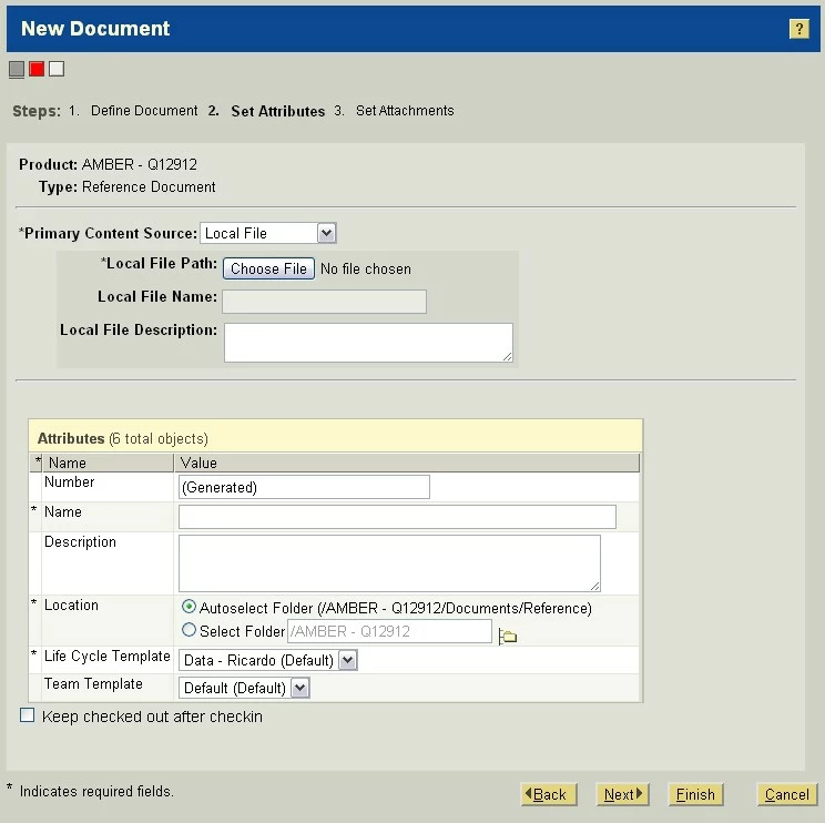

If the document type attributes, number and version scheme are consistentbut you want to apply a selection of differentlifecycle and team templates within a given context there is another option you could consider.
You can configure the object initialization rule for documents to allow the document creator to select the lifecycle and team template from a pull-down when creating the document. (If you trust them to pick the right one)
See attched screenshot of resulting document create wizard, sample OIR xml below
Regards Darren
