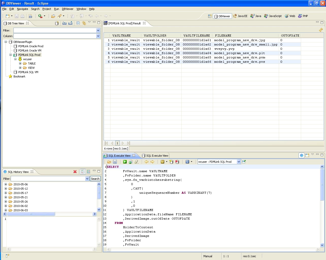

We have written a java app that queries the database to find the viewables for a particular epmdoc then copies from the vault to the local machine to open it.
Basically the user enters the epmdoc file name and the application goes out and finds what it needs then copies it the local machine.
I assume you could do this with other docs as well. Here is a screen shot of what the sql gives us. These are all the viewable files related to model_program_new.drw
