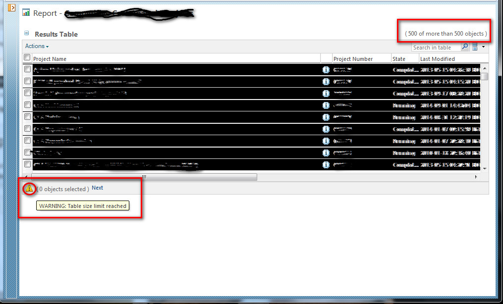

Hi Guys,
When I click one of my 'report' in Windchill Project-Link, I got a warning: table size limited reached. There only have 500 objects shown in the table. As a matter of fact there have thounds of objects.
Is there any way to make all my objects shown in one table one time?
Thanks in advance,
Sylar

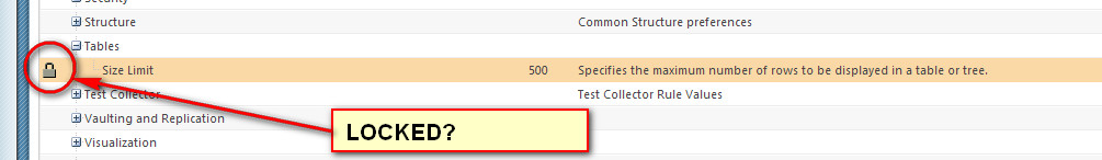

September 2, 2014
Can you increase value of the user preference Tables -> Size Limit and check if it works.
Regards
~Syed
sliu-21-VisitorAuthor
September 2, 2014
Thanks Syed. However I can't change the value. Seems like it's been locked. Any way to unlock it?
September 2, 2014
Ohh.. That means your admin has locked it. Not sure what permissions you have. Generally preference values are cascaded from the Site->Org->Context (product/library) levels. You can check if you are able to change it from Product/Library -> Utilities preferences.
Hope that helps.
Regards
~Syed
