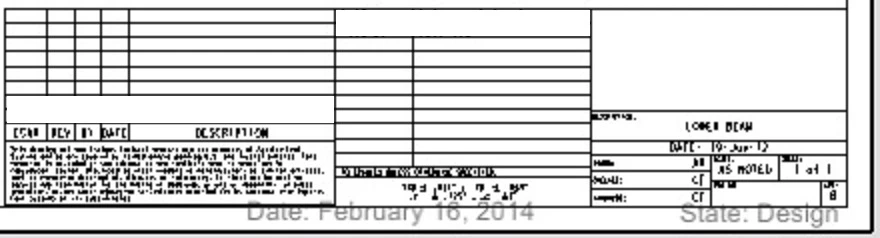

Feb 16, 2014 8:59 PM UTC
I did get the watermark to show up for a HPGL/PLT. I have attached the image.
But our publishing (like most) is set to Publish PDF's. The watermark settings are working, but its a publish format issue.
Unless some one knows the route to get those OOTB settings to work on PDF's, without iText or other customizations.
I am not opposed to doing the iText or other customizations, as long as they are free/cheap & dont take a lot of customization time, because I dont think the client is open to that much time spent on something that should be OOTB for PDF's.
Any ideas?

Feb 19, 2014 8:12 PM UTC
I thought I posted this comment, but I cant find it now.
Anyway, I finally seen my waternark work. But on a HPGL/PLT. But we publish all our DRW's to PDF.
Any idea why it will work for PLT & not PDF?
I attached an image that shows the watermark on a PLT.
