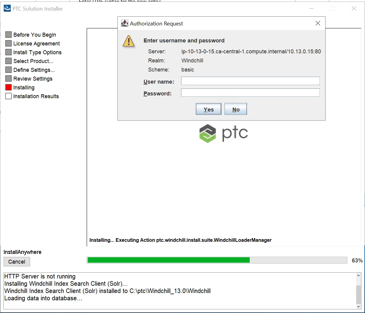

WC 13 PSI installation stuck, a pop up the " Authorization Request" window for user details.
Version: Windchill 13.0
Use Case: WC 13 PSI installation stuck, a pop up the " Authorization Request" window for user details.
Description:
Hello expert.
I am installing the WC 13 with Directory server as OpenDJ. Installation fails at the Loading data into Database. (I am using Windows server 2019 and oracle RDS service).
PSI installation stuck and waiting for authorization request pop up.  It was expecting the username and password. I tried to enter wcadmin but it's not authorizing it.
Not sure what's the issue with Authorization.? Can someone quick guide.

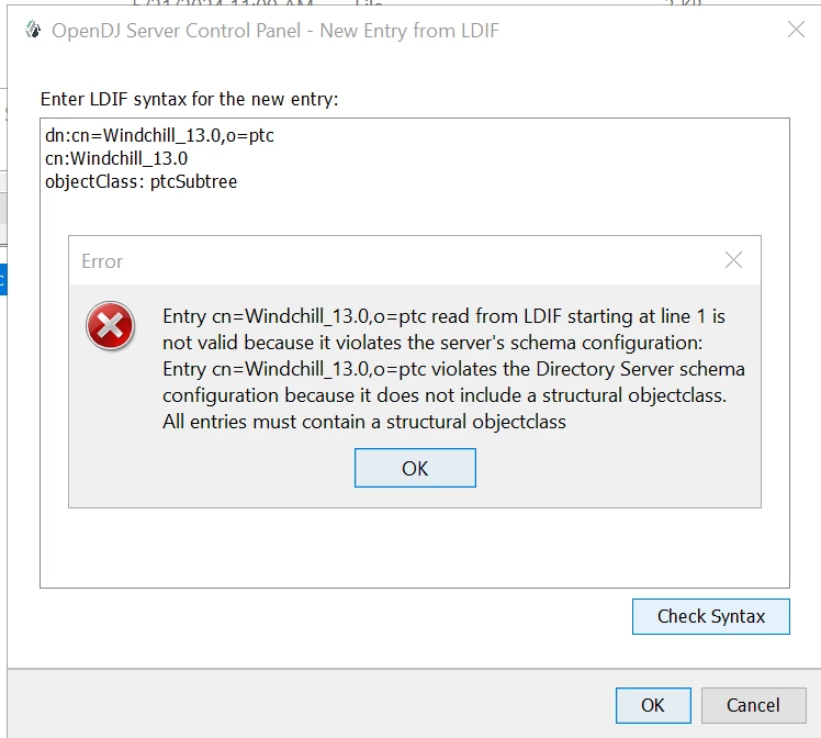

If this issue is related to OPENDJ then can someone guide me what i have missed. There is not much info available related OpenDJ ...like how to add etc.

Were you ever able to resolve this?  I'm running into the same scenario with Windchill 13.1.  (Also using OpenDJ but SQL Server RDS)
January 27, 2025
For me at least, I was able to (eventually) track this down to special characters in the password.  OpenDJ (rightfully, IMO) allows you to use special characters, obviously to increase the security of the password.  Unfortunately, there seems to be a limitation with the Windchill PSI that causes it to error out.
See this article:
Article - CS343728 - Fresh Installation of Windchill 12.0 with OpenDJ  is consistently failing at Info Engine, it popup login window during PSI installation and not accept the provided authentication information.
Hopefully this'll help if anyone else stumbles across this thread.
