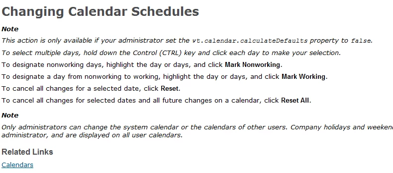

I am looking to change the way the calendar in WC views the calendar days associated to the workflow.
What I need WC to do is only account only for working days when calculating the due date of a workflow. Currently it does not exclude Saturday & Sunday when making the calculation.
I have no idea what setting to look for to change this or what it needs to be set to, to exclude the weekends.
Any help will be greatly appricheated.

I never did get my workflows to adjust deadlines based on the System Calendar weekend non-working days. So, I'd love to hear of any success here.
