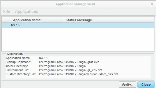

Hi Fellow Windchillers,
Windchill 10.1 M030
Have configured WGM for NX-7.5 and am trying to launch NX after creating a new CAD Part in Windchill workspace in the WGM client by accessing the CAD-Document information page and then select open in NX from the top menu. NX is launched but the part is not opened in it. Also on closing this NX session the WGM window is greyed out.
Have done the following settings on the client:
User variables:
WWGM_VFS_APPLICATIONS_ADDITION=C:\Program Files\UGS\NX 7.5\UGII\ugraf.exe;C:\Windows\System32\mspaint.exe
WWGM_VFS_APPLICATIONS_REMOVAL=C:\Program Files\UGS\NX 7.5\UGII\ugraf.exe;C:\Windows\System32\mspaint.exe
WWGM_VFS_PTC_PLACES=C:\PTC_Places
System variables:
PTC_PLACES_DEFAULT=C:\PTC_Places
PTC_VFS_INSTALL_DIR=C:\PTC_VFS
PTC_VFS_ROOT=C:\PTC_VFS
PTC_WLD_ROOT=C:\PTC_WLD
WWGM_ENABLE_VFS=true
ALso attached the WGM client settings for NX
Errors from Methodserver display the following information:
2013-07-25 12:08:05,141 ERROR [ajp-bio-8010-exec-1] com.ptc.windchill.uwgm.cadx.common.OpenInCadUtilities wcadmin - WTException Occurred.
2013-07-25 11:45:12,619 INFO [ajp-bio-8010-exec-1] wt.system.out wcadmin - RESOURCE: com.ptc.windchill.uwgm.common.conflict.UwgmResolutionTypeRB
Please let me know if there is additional configuration which needs to be done.

Amol,
What happens when you attempt to launch NX without WGM running first? Does it also successfully launch WWGM at the same time?
What OS are you running? If Windows 7 were the steps outlined in https://www.ptc.com/appserver/cs/view/solution.jsp?n=CS32028 followed?
Was this system upgraded?

Lori,
Thank you for the help! Am able to open a CAD Document into NX from WWGM session.
