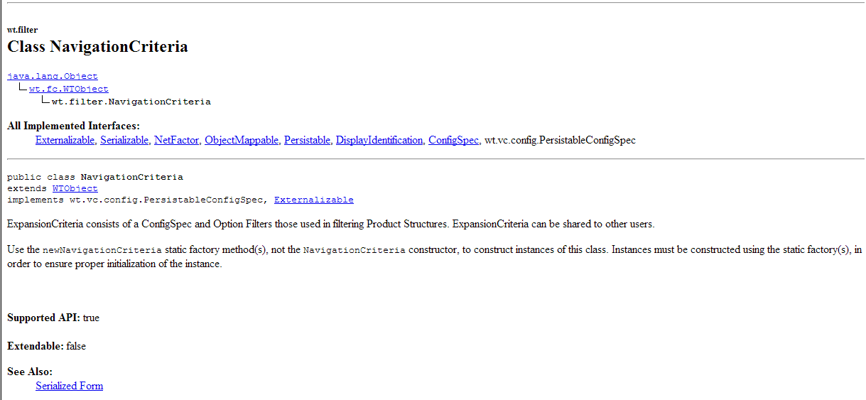

I am trying to collect all CAD Document using CadCollector.
Its asking for NavigationCriteria and seeds
I know seed is WTCollection of EPM and I am not able to get any details about NavigationCriteria in APIs
Suggest me some right direction to NavigationCriteria.
Best answer by LoriSood
This class is explained in the Windchill Java Docs:
Additionally, CS81089 gives an example of how to initialize and use the object type.
LoriSood23-Emerald IIAnswer
23-Emerald II
September 6, 2013
