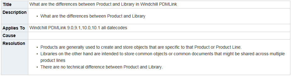

Hi Guys,
Could any please explain me what is the difference between a PRODUCT and a LIBRARY in Windchill PDMLink?

The referenced CS says "there are no technical differences between Products and Libraries..."
There is one HUGE difference: Products have on their Details page the "End Items" table. Libraries do not have this table.
The End Items table is a subset of the WTParts in that context - those with End Item = True. It only applies if you are using WTParts and Product Structure - and have designated End Items where appropriate.
The table, if Parts are maintained, becomes a very convenient top-level point for each Product Context to access all the actual items that you sell to customers from one place, and drill down to the details of each.

Lack of end items table is the only difference I know about.
You can add an end items table to a custom tab of the libary details page, but in that case you might as well use a product container.
