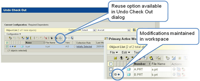

Workspace Undo-Checkout
There are multiple reasons for deciding to undo a checkout. You may want to discard the latest changes to an object and return to the version of the object stored in Windchill, or you may simply want to remove the lock that your checkout has placed on the object.
When you undo a checkout, changes you have made to the content and meta-data of the object are discarded and the content as stored in Windchill is downloaded to the workspace. You can choose not to have the Windchill content downloaded.  The resultant item is flagged as locally modified and the content is available in the Workspace.
Note: A Reuse option for the Undo Check Out action is only available with Pro/ENGINEER 4.0 M070 and later. This option allows you to retain local modifications that have been saved to the workspace upon undoing the checkout. The Reuse option is only available when the Undo Check Out action is initiated from a primary active workspace viewed in the embedded browser. It is not available in standalone mode. Beginning with Pro/ENGINEER 4.0 M110 and later releases and also with Pro/ENGINEER 5.0 M010 and later releases, the Reuse option applies to objects whose modifications have been uploaded. At earlier release levels, the reuse option is not applicable to objects whose modifications have been uploaded.
Note: The Undo-Checkout functionality is only available within the embedded browser.

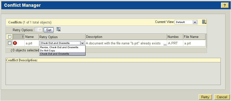

Workspace Save As
Using the Workspace Save As users can now specify an existing filename during the Save As action.  Windchill will save the content of the source model as a new iteration or revision of the target.  The user is given an overridable conflict where the user can choose from the following actions:
  • Revise, Check Out and Overwrite
  • Do Not Copy
  • Check Out and Overwrite
