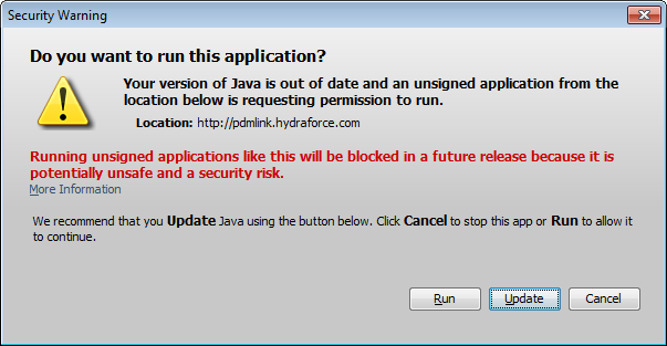

Apr 25, 2016 6:38 PM UTC
We are on PDMLink 10.1 M050.  We are starting to use IE 11 more and more.  It is supported by PTC on this version and build but I don't know off-hand about previous builds.  We also are currently on 2 different versions of Java.  Version 6 Update 38 or version 7 Update 76.  They both work.  We started out with 6 U38 for everyone when we went to 10.1 M040.  Then since we went to M050 I did some testing of several different Java versions and decided on 7 U76.  The only thing with 7 is it displays a dialog box asking you to Run or Updated.  Annoying but manageable.  On the upside I was having problems with showing the workflow in the template administration.  It would work on the icons the first or second time you try to open one but after that it wouldn't.  Java 7 fixed that for us.
