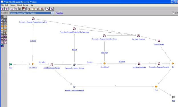

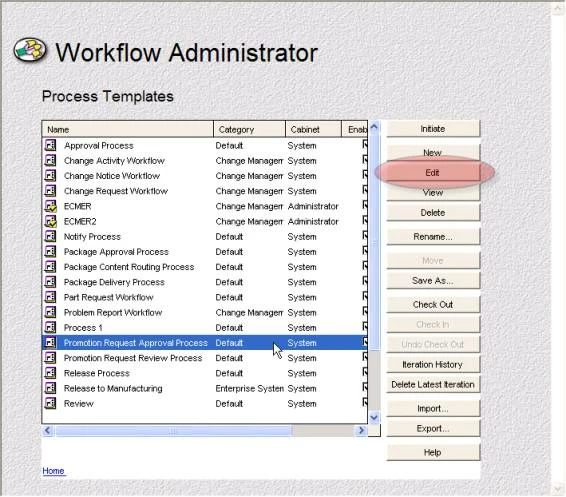

The keyboard shortcuts Clrl +Key such as Ctrl +C/Ctrl +V for Copy/Past in the worflow editor (edit acyionn in the workflow administrator ) are disabled in the disabled in the 9.1 M070, was enbled on the M040 , and after update only Copy/Pasthe trough a right mouse click or the via the Menu are available .
