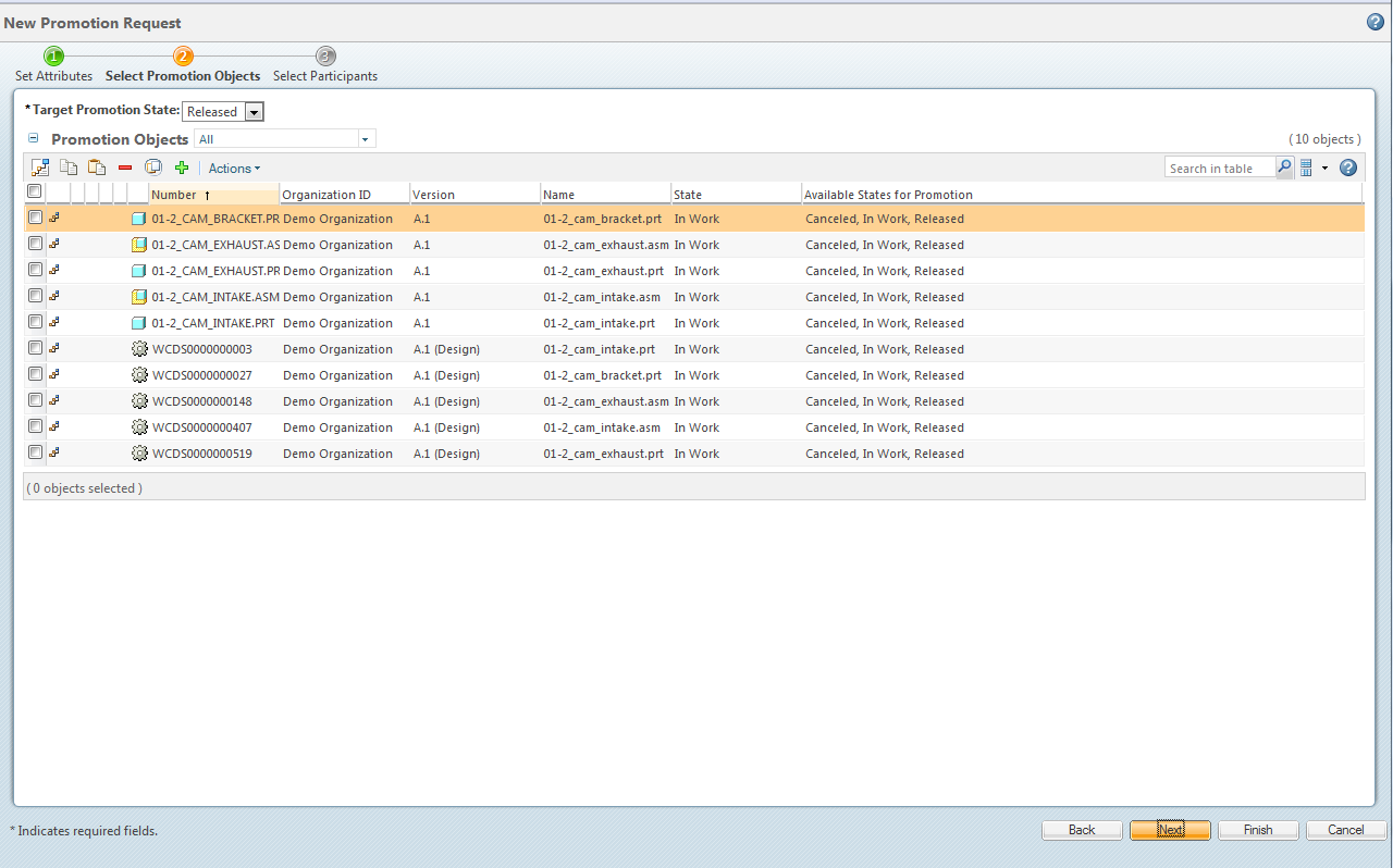

The Promotion Request process in Windchill 10.0 has been enhanced to make it easer or more powerful than ever.
Some of the improvements include -
  1. 50% reduction in steps in the process - less time for users to create a Promotion Request.
  2. Users can now add or paste additional items into the Promotion Request - not just collect. This gives users a huge boost in flexibility when adding data to a Promotion Request.
  3. The selection of Particpants and Workflow is simplified in one step.
To find out even more of What's New - Download the 10.0 Preproduction Release or grab the What's New Guide (Reference Documents in Support at http:\\www.ptc.com). The download information is at this posting:
Windchill 10.0 (C000) Pre-Production Now Available
Have a wonderful Holidays.
Here is a snapshot of the Promotion Request
