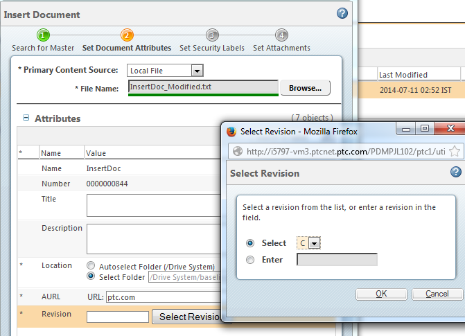

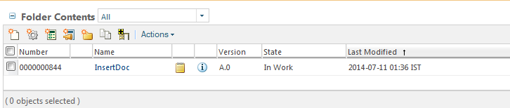

Short-term workaround on a more granular level: With regards to documents, you can achieve this using the "Insert Document" action. (You can also do this with a part.)
  1. Doc 1 A.1 --> checkout to lock/hold OR just don't check it out
  2. Modify the primary content
  3. Perform the Insert Document action. Here you can upload the modified primary content and set the same attributes you would set during a check in operation.
  4. Results:
    Doc 1 A.1 -- old content
    Doc 1 B.1 -- modified content
  5. If you checked out Doc 1 A.1 to lock it, you can just perform an undo checkout
See "Inserting a Document"
Limitations -
  • Straightforward but requires a little more effort.
    • The Insert Document window includes a step where you are required to copy/paste the object number to find it. You can't preselect the document like you can with check in/revise.
    • You are required to upload/change the primary content. There is no option to keep the existing file and modify the attributes only.
    • It is essentially treating the action like a New Document action. Meaning that if there are required fields in a New Doc layout, they will also be required here. However, you can use the Type & Att manager to change some of this.
    • The "Revision" field is a little clunky. It doesn't automatically assign the next revision label unless you click the "Select Revision" button. Not difficult; just more clicks.
  • Only available from Folder Contents > Actions
  • No Collect Objects step as there is for the Revise action
  • Can't contribute checkin comments
