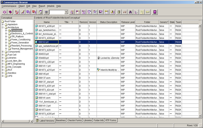

Some notes here on this topic -
  • There is no reason the Pro/Engineer drawing needs to show the iteration at all. The mechanism to show revision or revision/iteration is no different than in Intralink 3.x
  • If you start playing with the data utility you run the risk of giving your users some very confusing results. For example
    • If they do an all version serarch you will see a list with B.1, B.2, B.3, B
    • Depending upon the configuration specification used to return a CAD or Part structure you will see mixed revision or revision/iteraion (and this might not work for many UIs)
    • Inconsistent results in reports
  • Intralink 3.x also showed revision / iteration so this is not a new concept - example -

Thanks for the reply. I do realize that the drawing doesn't need to show the iteration. And I know that Intralink 3.4 already showed Revision and Version.
But the information in Intralink was only seen by the Deisgn Engineers here. Everyone else downstream (manufacturing, marketing, vendors, etc) only saw exported pdf copies of the drawings. So they only saw the Revision. The plan is that once we get Windchill 10.0 up and running, we will open it up to many people beyond Design Engineering. And some folks are concerned that these new people will be confused by seeing 'B.5', for example. Especially if the drawing still just says 'B'. We have guys on our shop floor who have been working off drawings for 10 or 20 years or more, and they've never seen anything besides a letter there.
Based on the other thread linked above, it seems as though we aren't the only company that is worried about something like this. And the answer there indicated that some sort of fix is possible. I guess my question now to everyone is whether, in your experience, people who use Windchill besides Engineers understand how revisions, versions, and interations work. In other words, is it better for us to attempt to play with the data utility to keep information in a format that people are used to, or is it better to tell everyone that this is the way it is now and that they'd better learn how to use it? This includes shop floor workers, marketing execs, suppliers in China or elsewhere, etc. Thanks!
